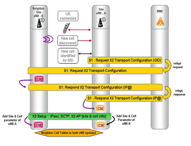

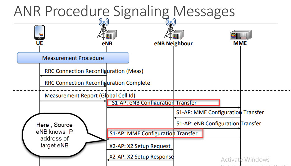

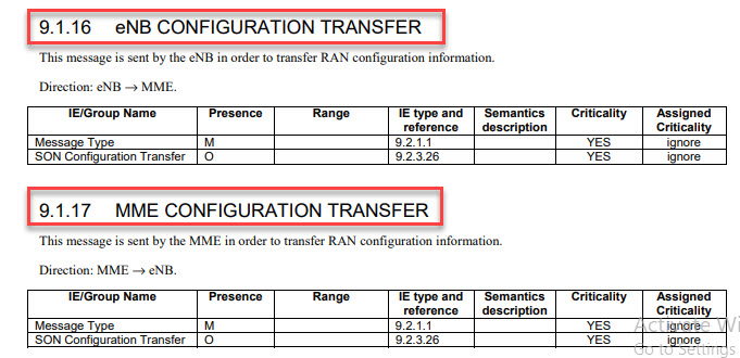

Hello Bro,
Actually MME is a main part for identifying and adding IP address of target CGI NBRs. IP address is derived via S1 SON Information exchange → which is IEs in MSG S1aP.eNB Configuration transfer
Also please check below link :
