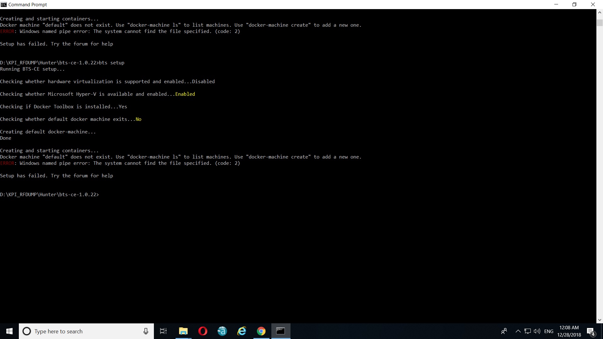

ERROR: Windows named pipe error: The system cannot find the file specified. (code: 2)
Default Machine created after disabling hyper-v hypervisor
@Murali We are looking into this. Will get back to you tomorrow.
@sendyramen did your problem resolved, if so how

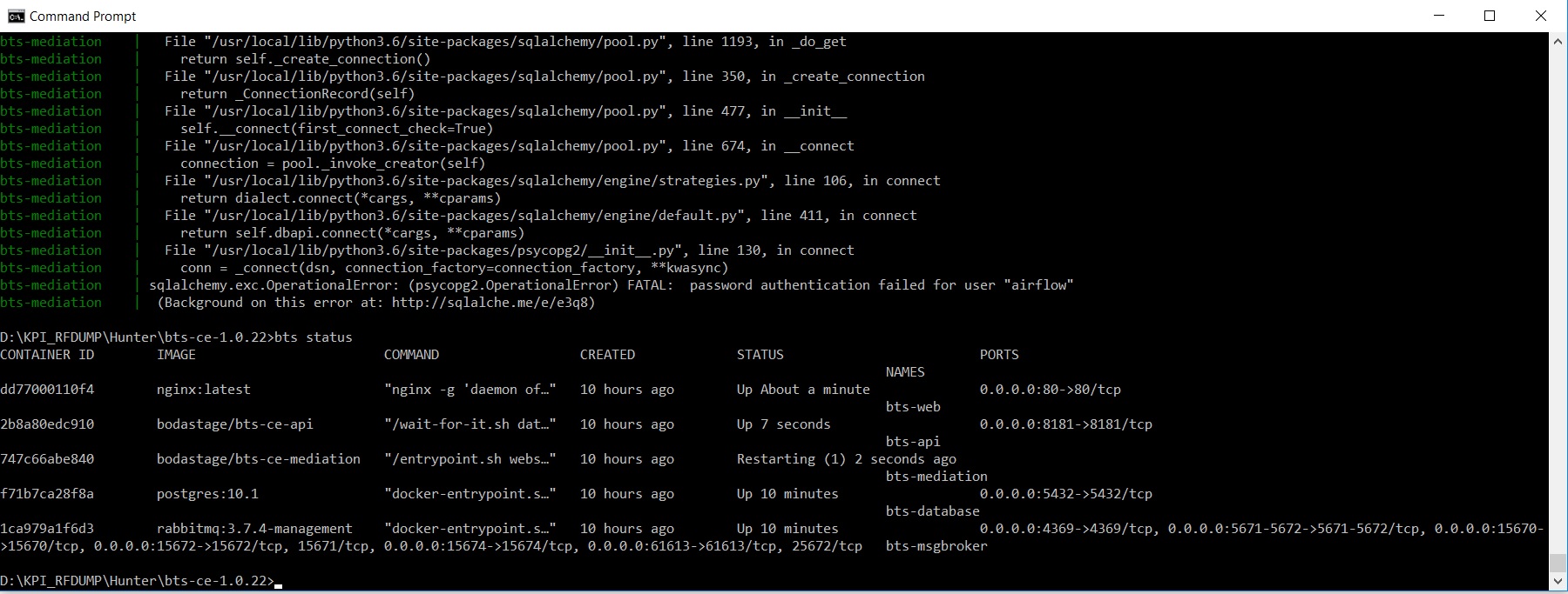

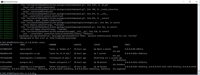

Have you had any luck with this? I’m having the same issue even with the latest version downloaded from Release v2.1.0 · bodastage/bts-ce · GitHub
Mediation log gives me the same error “FATAL: password authentication failed for user ‘airflow’”.
Still Working with Emmanuel
