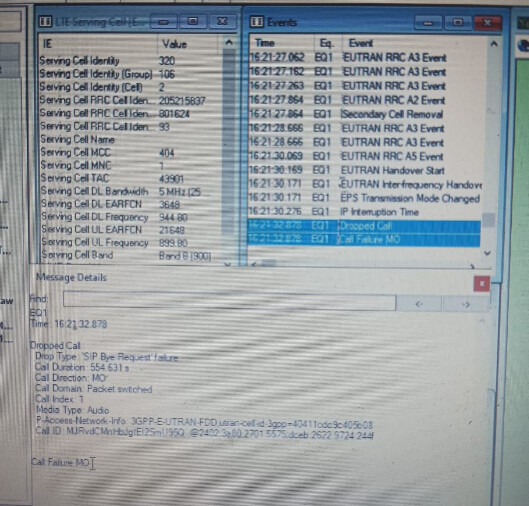

What does drop type 'SIP Bye Request' in tems mean?

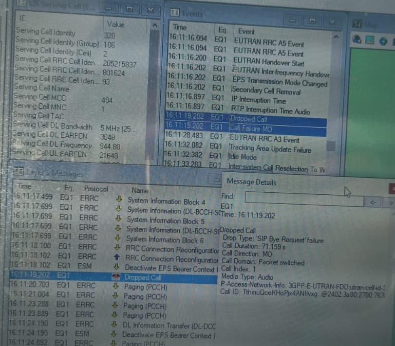

What is the Reason for call drop here?
What’s the reason for the first SIP BYE?
RTP timeout?
If yes, it means there are no more DL RTP packets for last 15-20 seconds.
So go check DL SINR or MAX TX POWER on both UEs.
It is very important to check who is sending / receiving first the SIP BYE message and cause of BYE.
SIP BYE can be either UL or DL message.
Facing issue b/w plmn sites (Delhi → Haryana).
