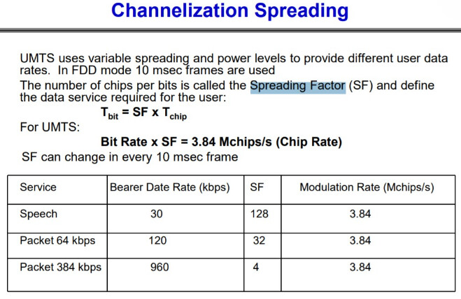

Do we have a rough estimation on how many simultaneous CS users can one 3G cell handle?
I’m just curious how you manage frequency reuse in this case?
You will have a C/I of less than 5.
If you take the spreading factor limitation it will be max 128 ( because SF is 128 for voice) but it is less than this.
3G is DL capacity limited and uplink coverage limited.
So you need to take both into account.
