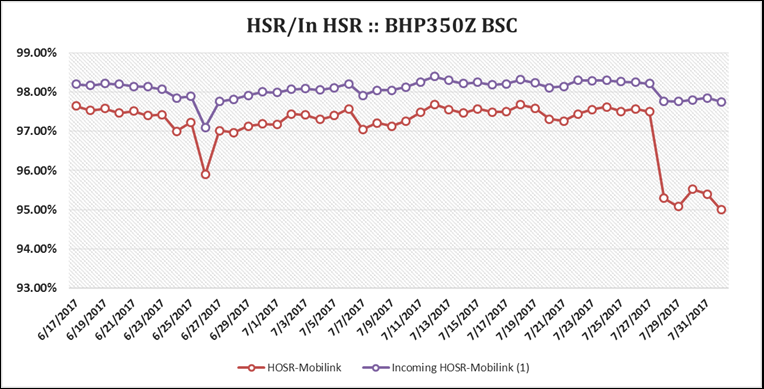

I am facing an issue regarding HOSR/IHSR sudden degradation on some sites which belongs to same servring area ( As shown in below picture) causing BSC level degradation in the network, I am working on ZTE vendor. Kindly help me out to resolve it. Also these sites belong to one BSC with no external boundary or MSC boundary.
BSC level HOSR/IHSR Trend.

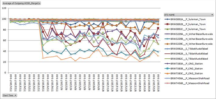

Cell level trend

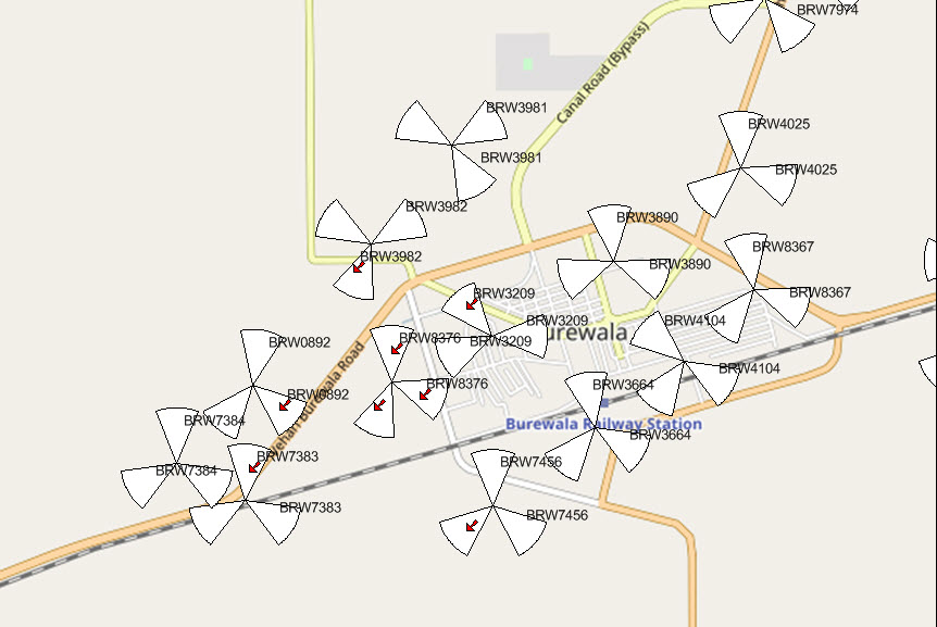

Degradaed cells geographical location.

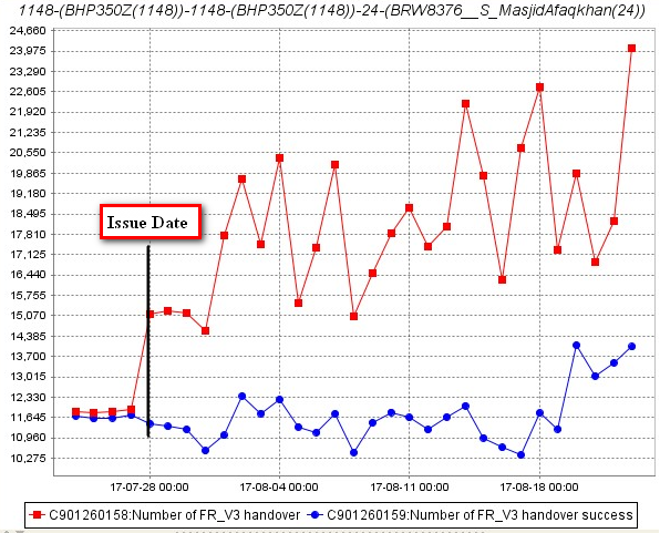

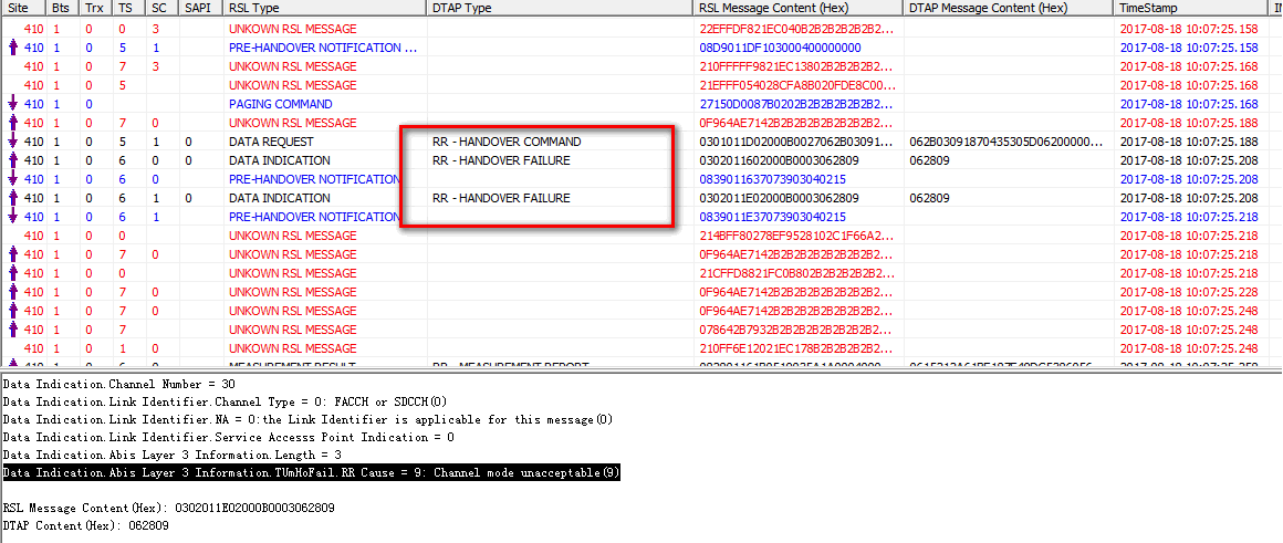

- Also from the DT results,no obvious handover failures were found. From the RCT tracing results, we have found that the HO Fail cause: Channel Mode unacceptable. And we have checked that only Speech Version3 have big increasse HO attempts. Our Experts says that the Speech version also need to be configured by CN, pls also let them help check. For the illustration of speech version, pls see following:
Further they say that there may be a certain type of Mobiles which does not support preferSpeechVersion AMR 3. Kindly support for resolution.
