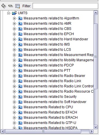

thank you for answer, on U2000(iManager) i can’t find any counter with name start of VS.RAB. can you alsow pls help me with this problem?
We usually use PRS for KPI and counter…
But in U2000, the counters should be under “RAB RELEASE MEASUREMENT”
