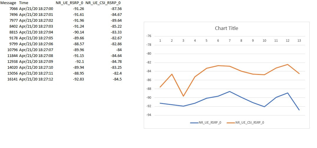

I see in UE logs that csi-rsrp is different than SSB RSRP:
csi-rsrp is stronger than SSB RSRP.
How do you see csi-rsrp?
SSB no power control.
csi has pc, fix or dynamic, I am not sure.
Some special logs there is csi-rsrp.
What is weird is that ssb graph and ssb graph are different.
