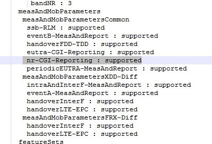

Huawei has it but very few UE supports CGI reporting for ANR.
Huawei P40pro supports it:
Actually Mate 40 Pro chinese version is the only UE that has this IE present: nr-CGI-Reporting-ENDC
All the other phones do not have it…yet.
So it mean UE having ENDC can add LTE to 5G SA cell?
