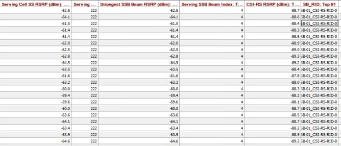

Hi family, In dt I see a big gap between Serving cell ss rsrp and csi-rs rsrp in tdd like 15-20 db. (6beams for ssb)
I checked sspbchpower and csirs power configuration, they are same. What could be the reason of this difference in tdd?

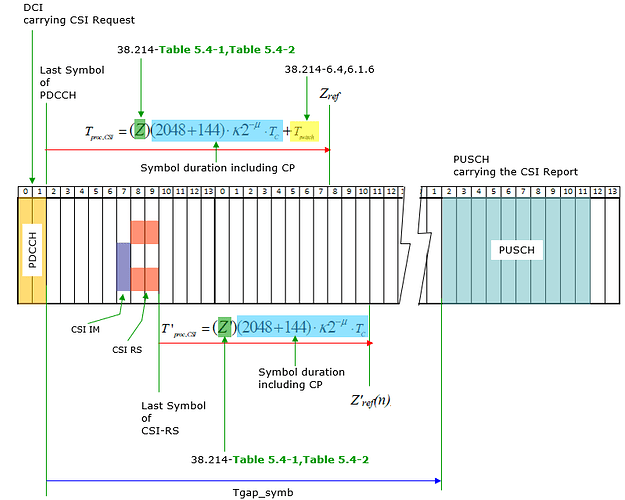

According to below source:
UE calculates csi-rs after some time calculated and reports in PUSCH.
So if PUSCH power somehow is limited it can impacts the reported value or
if CSI-RS measured signal is interfered… Still not clear to me…
