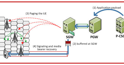

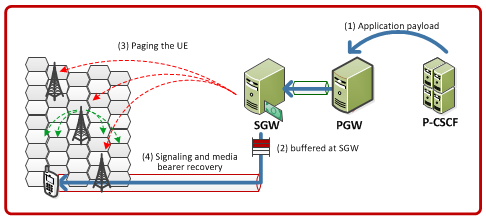

Think about E2E call flow: what is the event triggering that paging and what is the path?
IMS → PGW → SGW → eNodeB
Untill IMS it is signalling.
After IMS it is data payload.

maliseker:
As far as I know, IMS doesn’t have mechanism to ‘page’.
It can only send SIP message to PGW, which then triggers the paging in RAN.
If Party B is in idle mode, then the paging will be network paging to wake up the UE and connect.
In this case RRC Request will be MT.
If Party B is in connected mode, then I believe paginG i.e. call alert comes directly on QCI5 and via IMS.
This is very good breakdown of entire call flow:

Thanks for sharing this is explaining my statement very well.
This
And this
SIP message is signalling that triggers paging over Packet Core network, because it is a data payload after PGW.
What I say is, if that SIP message is triggered all the call handling is completed on the IMS side and there is a valid IP contact for UE over IMS APN.
