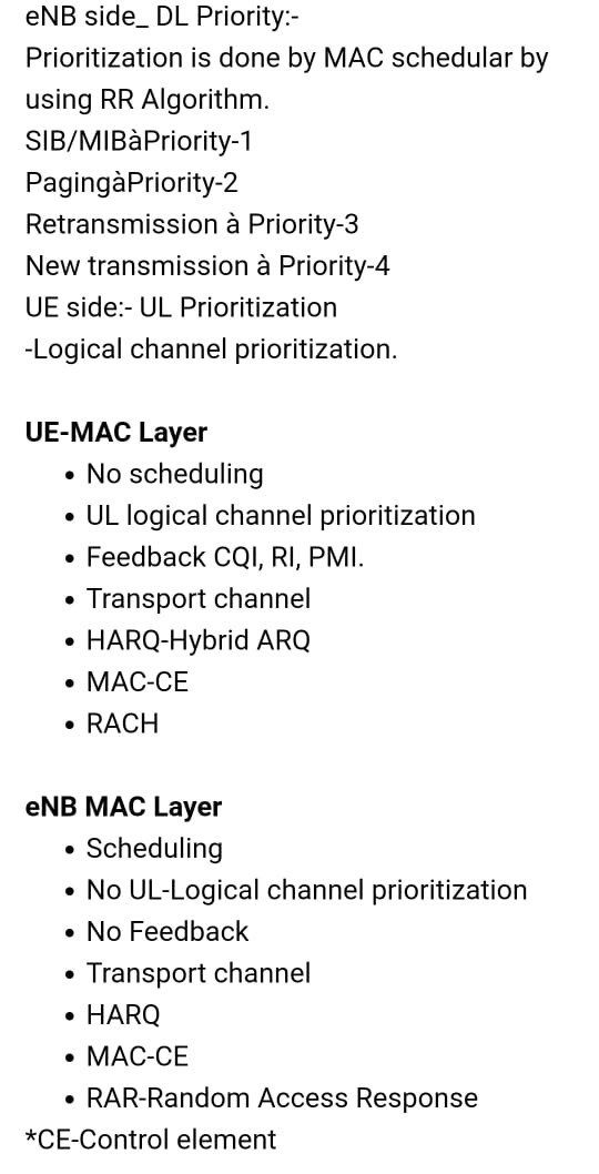

From above snapshot why UL logical channel prioritization required at UE end MAC layer, but not at eNB end MAC layer?
