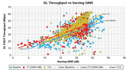

As we’re talking about CRSGAIN, i would like to know the value of CRSGAIN Per BW.
Is there any calculation per BW and POWER that we set?
For example CRSGAIN of 20 MHz, Power 80 W and 2x2 MIMO.
