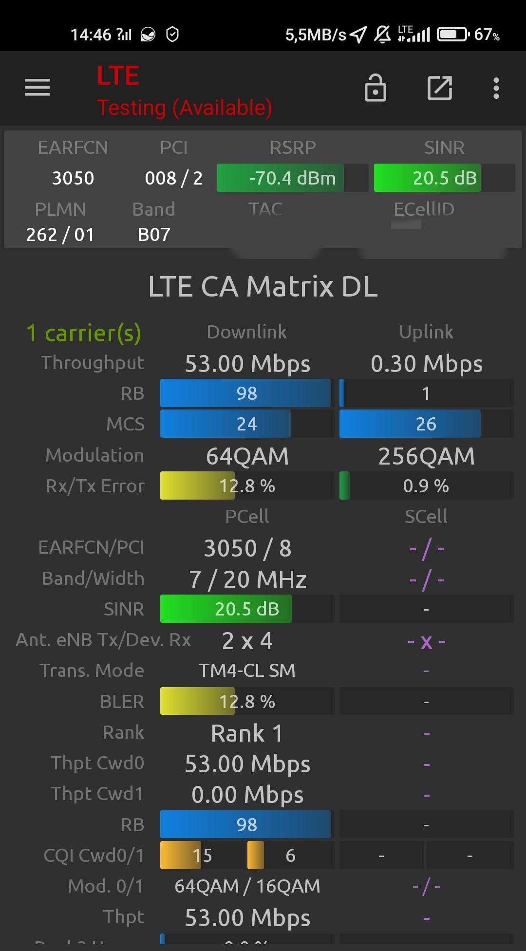

Since some time my device isn’t able to use 256QAM for DL. It just uses 256QAM for UL and only 64QAM for DL. The device does know 256QAM since it made 256QAM some days ago, now it doesn’t. I’m confused and I don’t know what to do.
Someone said a high BLER is causing the eNb to keep 64QAM. The BLER is between 12-17% - depending on the used LTE Band. Is this correct? If so, what can I do to reduce the BLER to get 256QAM DL back?
This eNb can 256QAM. Like every other eNb I was but just the UE doesn’t use 256QAM DL. Other devices do 256QAM on the same eNb and the UE that doesn’t use 256QAM there, uses 256QAM on other provider networks.
User need to check intra site/inter site overlapping to check why so high BLER if BLER can be reduced by physical optimization it will be best solution.
Apart from this check value of dltargetbler set it around 10%.
