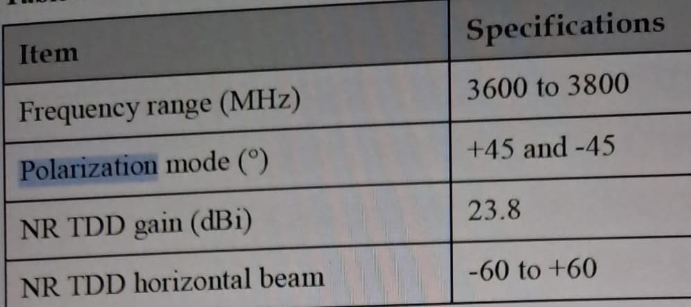

Hello experts,
Could someone please explain the difference between cross-polarization and co-polarization?
Also, what do +45° and -45° mean?

As far as I know, it refers to cross-polarization for massive MIMO antennas. The definition of cross-polarization is the ratio between the undesired polarization and the desired polarization.
My question is: why do we focus on the undesired polarization when our main concern is the desired polarization?
Why is cross-polarization used more frequently than co-polarization?
Does the -45° and +45° indicate that the polarization used for this antenna is cross-polar?
Cross-polarized antennas combine vertical and horizontal polarization components, enhancing signal reception and transmission in environments where signals may reflect, refract, or scatter.
This polarization diversity helps reduce signal fading and improves overall reliability, especially in challenging environments like urban areas with many obstacles.
Exactly!
Thanks, everyone.
Now, another question: What is recommended for use in 5G NR - cross-polarization or co-polarization?
Can we determine the appropriate type of polarization from the antenna datasheet?
I believe cross-polarization is more commonly used, and I think it’s because phones are more likely to be tilted rather than perfectly vertical or horizontal.
Cross should be used.
When I say Cross-pol Isolation 28 dB min, or 30 dB min means what?
If my antenna supports Polarization of Dual Linear means, what does it indicates
Cross-pol isolation means the difference between receiving a signal in the co-polarization and receiving a signal in the cross-polarization. -30 dB means that the signal in the cross polarization is 0,001 times the main signal. A difference of -30 dB is better than -25 dB.
Co-polarization means the same polarization. Cross-polarization means a polarization that is twisted by 90 degrees from the co-polarization. By +45 and -45 polarization mode, it refers to two signals being transmitted in the same time, each in a polarization in a way that resembles the X letter, but it is actually a cross, twisted in 45 degrees, so one polarization is twisted to one side 45 degrees and the other polarization is twisted 45 degrees in the opposite side.
