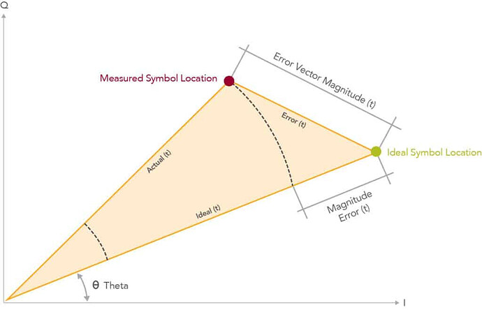

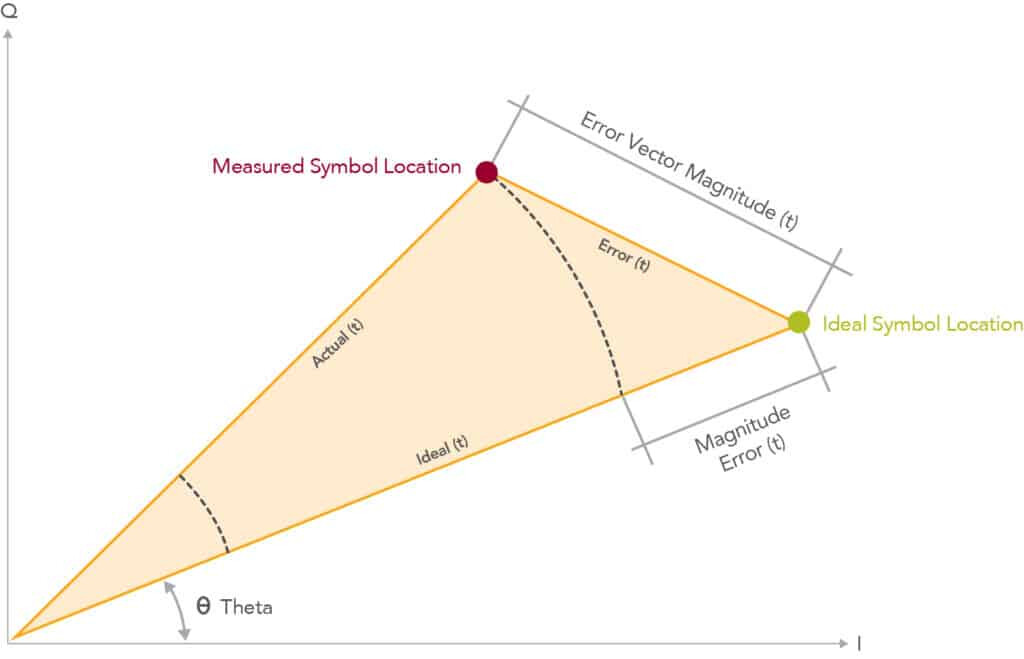

Good article on EVM. Focused on Wi-Fi, but also apply to EVM in 4G and 5G:
EVM (Error Vector Magnitude): Why it Matters and How it’s Measured
EVM (Error Vector Magnitude) is the key metric used to evaluate RF transmitter performance, because it provides a consistent “yardstick” to characterize the transmitter regardless of the receiver implementation and it encapsulates a wide range of possible impairments on the transmitter chain into a single measurement.
New Wi-Fi generations have increased the modulation constellation size with 1024-QAM and 4096-QAM, placing an even higher requirement into transmitter accuracy. In this blog, we will look at what EVM measures in Wi-Fi and how it is measured.
