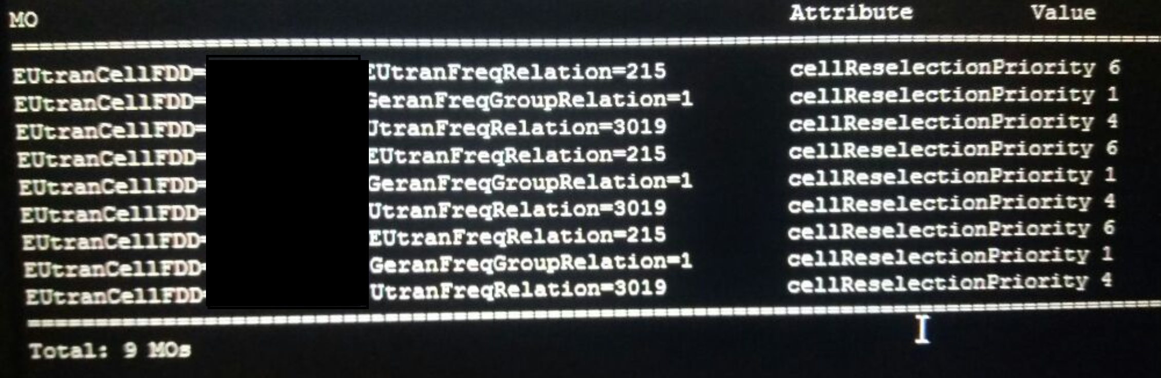

i have checked & found lte set priority level 6 in nodeb
What is priority of utran?
The priority is 4
So you have higher priority of LTE, then system is working fine…Reverse it if you wanna otherwise.

Did you reset the cell after setting priorities? What is the priority for eutran you are receiving in L3?
Share SIB19 from L3.
