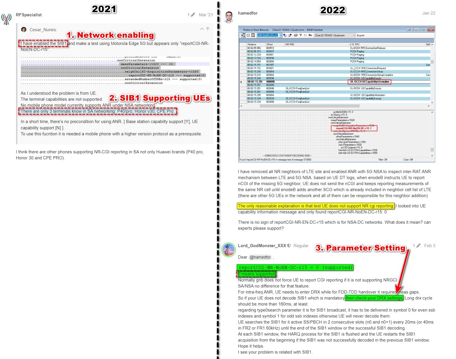

Yes, in UE CAP there is an IE declaring UE support.

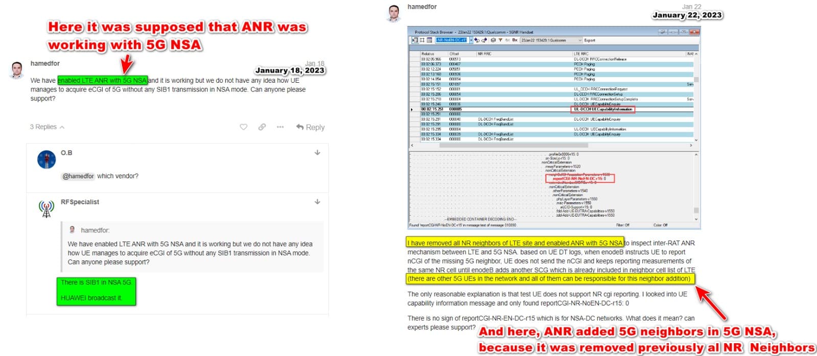

Which vendor?
Normally UE does not need sib1 in NSA but in case ANR for UE to decode CGI it first needs to decode MIB and Sib1 to extract CGI.
Yes for ANR it’s mandatory to read sib1.

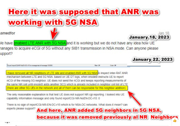

I am aware for one vendor, NR-NR ANR does not need SIB1 or UE support. It is created via the anchor
For LTE-NR ANR, SIB 1 is needed for UE to report NCGI

I think there are the 3 issues to review (I’m learning with this forum, only reading and summarizing what other experts commented some time ago):
Enable SIB1 in 5G NSA
Check if UE supports reportCGI-NR-EN-DC-r15 (0 means supported)
Check if parameters allow measuring of SIB1 (for instance: DRX settings)
Please correct if I’m wrong.

Enable SA on gNB but restrict SA access
According to the messages referred on the post, I think it’s NOT UE dependent.
I mean, after Network enabling (by setting parameters), only capable UEs (which can support “reportCGI-NR-EN-DC-r15”) will report measurements.
Previously, I think that some network optimization must be do to ensure UEs can work with this functionality (for instance: DRX settings)
There are two flavors of ANR:
UE based: will require the UE to measure and report NR-CGI by reading SIB1 of NR cell. If your network runs on NSA/SA dual mode, SIB1 will be there. UE needs to support this measurement by sharing reportCGI-NR-NoEN-DC-r15 and/or reportCGI-NR-EN-DC-r15. Once the UE reports the unknown PCI the eNodeB can ask 5GC/EPC for details about the target NR cell in order to create the X2/Xn, or ask OSS for its own database to obtain the information.
OSS based: requires no extra measurements from the UE. By regular measurement reports for regular mobility, if a unknown PCI is reported, the eNodeB will query the OSS for details about the target NR cell in order to create the X2/Xn.
Where I work, we did a manual creation of the initial list (based on cell refs, distance criteria, etc…) and then activated ANR UE Based on top of it.
