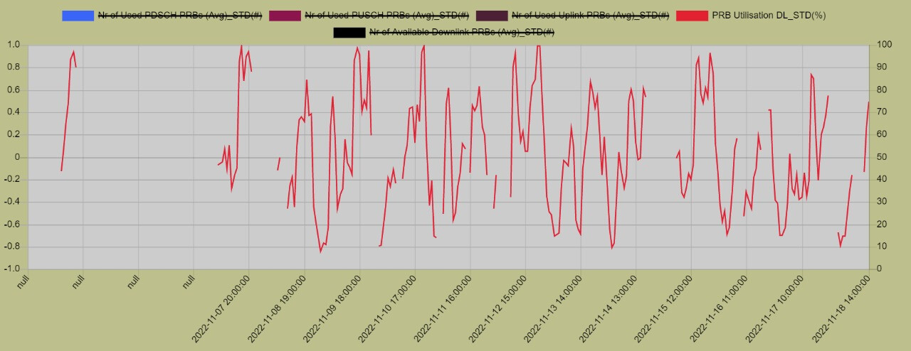

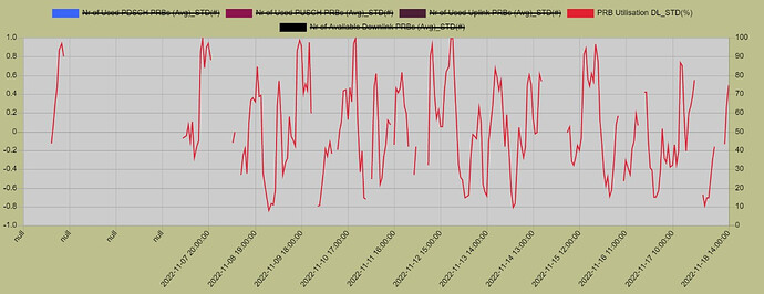

High PRB utilization during pick hours affecting data speed
If I am having high PRB utilization during pick hours which affect data speed, what are the best recommendations?

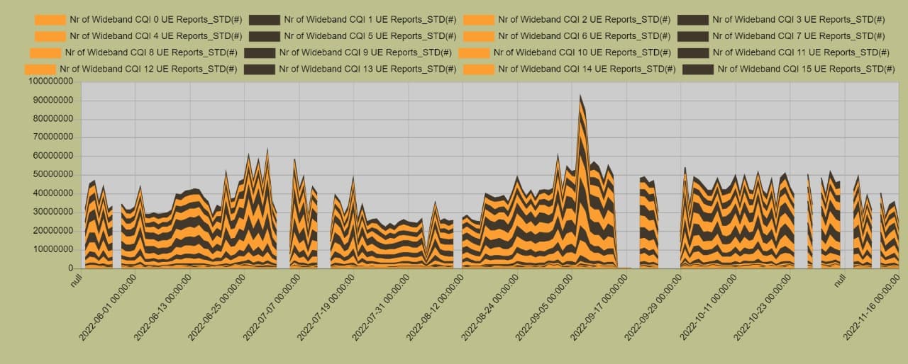

What is the average CQI in the cell?

This show users in a particular CQI. Can you check average CQI during the peak hour? If CQI is bad, it may need RF optimization like antenna orientation, tilt etc.
