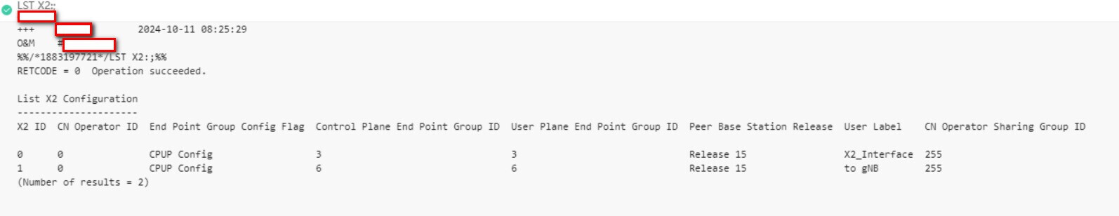

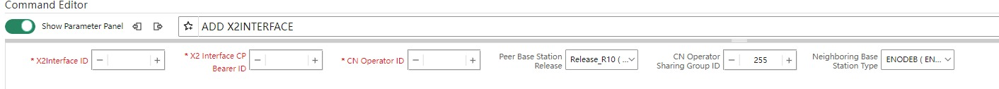

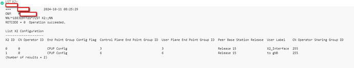

You need to add the X2 interface first:
Thank! Do you mean to add the IPs? Do you have the script?
Thank you!
You may also just establish connection with MME and X2 configs may self-establish.
