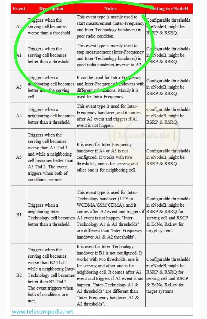

I have some confusion with A3 & A5 Event in LTE.

I went through the Nokia document.
It says A3 is used for Better Cell and A5 is used for Better Coverage.
And I check in the site both are actually enabled.
Is it required both to be enabled? If not, which one is better?
I think if we enable better cell only, it covers the cases of better coverage as well but no of handover attempts will increase.
Can anyone please comment further?

Isn’t A1/A2 applicable only in case of Inter-RAT or Inter-Freq cases?

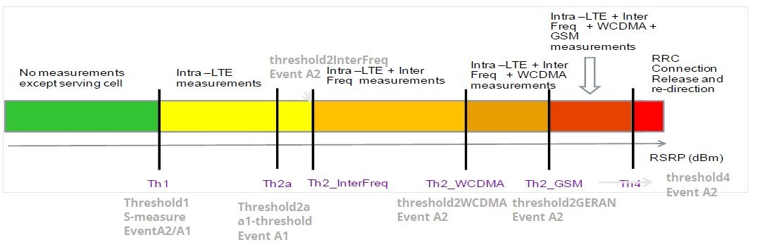

Mobility is done through a sequence of thresholds & hyst values.
When a UE is degrading it RSRP / RSRQ levels, the first step to trigger Intra-LTE Measurements.

Threshold1a is for triggering intra freq meas.
Intra freq use A3 offset plus hys.
For If, use A5, that’s it.
For A5 there are 2 thresholds, thresh1 for serving cell and thresh2 for target cell rsrp.
Of course UE should not enter meas gap all the time.
Therefore you need to set A1 / A2 for start stop measure.
You can’t enable a3 and a5 for either intra or inter at yhe same time.

For Ericsson case, start of IntraFreq measurements depends on “sMeasure” parameter configuration.
I’m not sure if for Nokia case “threshold1a” has some relation with “Event 1”, remembering that in general “Event 1” is used to stop interfreq-inter RAT measurements.
threshold1 is related to sMeasure.
tthreshold2a is used to stop interfreq / RAT measurement in case of Nokia.
