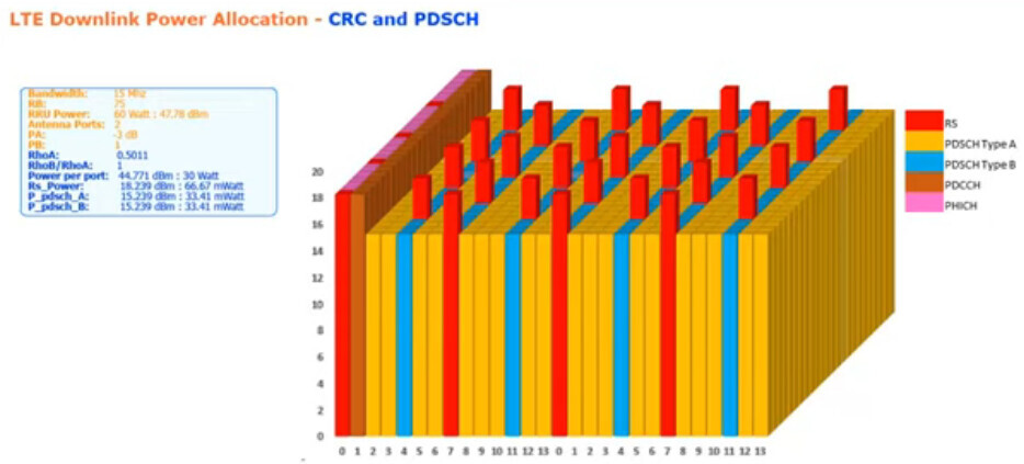

Try to take a look at the following links:
https://www.sharetechnote.com/html/Handbook_LTE_RSRP_EPRE_TotalPower.html
https://www.sharetechnote.com/html/Handbook_LTE_DownlinkPowerAllocation.html
LTE downlink power calculation: CRC power, PDSCH type A and B using the parameters Pa, Pb, rho A and rho B
This video explain the LTE reference signal power calculation, power of PDSCH type A and B using the parameters Pa, Pb, rho A and rho B.
With calculation examples.
