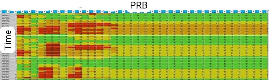

For me, it is best to see the entire spectrum and not the cell average.

You can check Interference.
