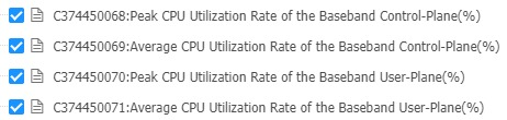

Please search in PRS (For Huawei), you can get the shared CE available, and shared CE used.
I don’t know the exact counters names.
In ZtE u31 search in the parameters KPIs.
In Huawei use PRS and search the KPI as mentioned.

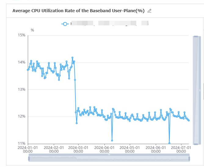

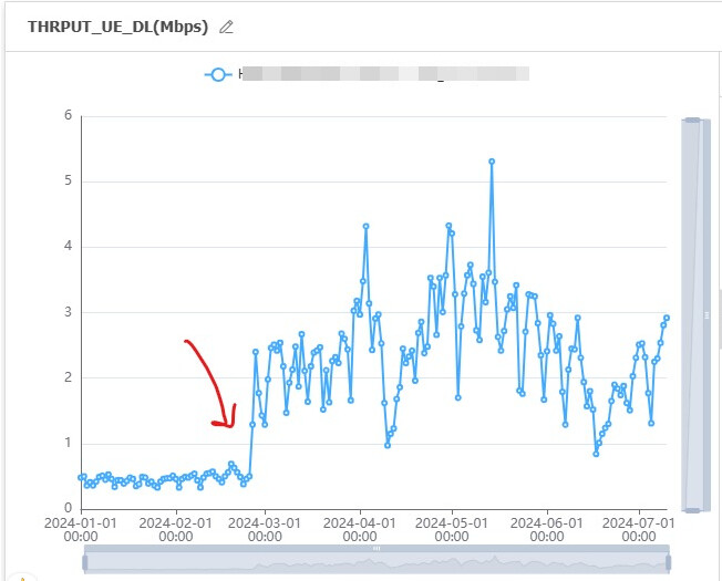

We allocated one baseband card for 2G + 3G & 4G while inserting 2nd baseband card.
Throughput and traffic has been increased, but I am confused that why the utilization rate is about 14% before inserting 2nd card.
It should be about 90 or 100 %.
And throughput is increased:

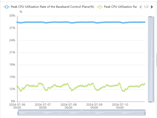

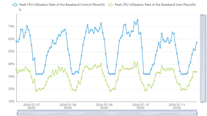

You are using counter for average value, use peak value which gives more clear picture.
And Also Control plane Utilization is more than user plane.
In the chart given you are taking user plane utilization.
