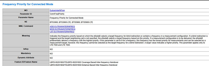

There is a separate parameter for connected mode within the same MO, EUTRANINTERNFREQ.

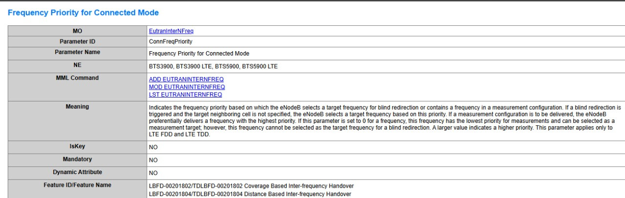

This is why I believe the CONNFREQPRIORITY parameter from MO → EUTRANINTERNFREQ is the correct one.
Since it is set to zero, I assume that in connected mode, the handover will be directed to the cell with the best radio conditions.
