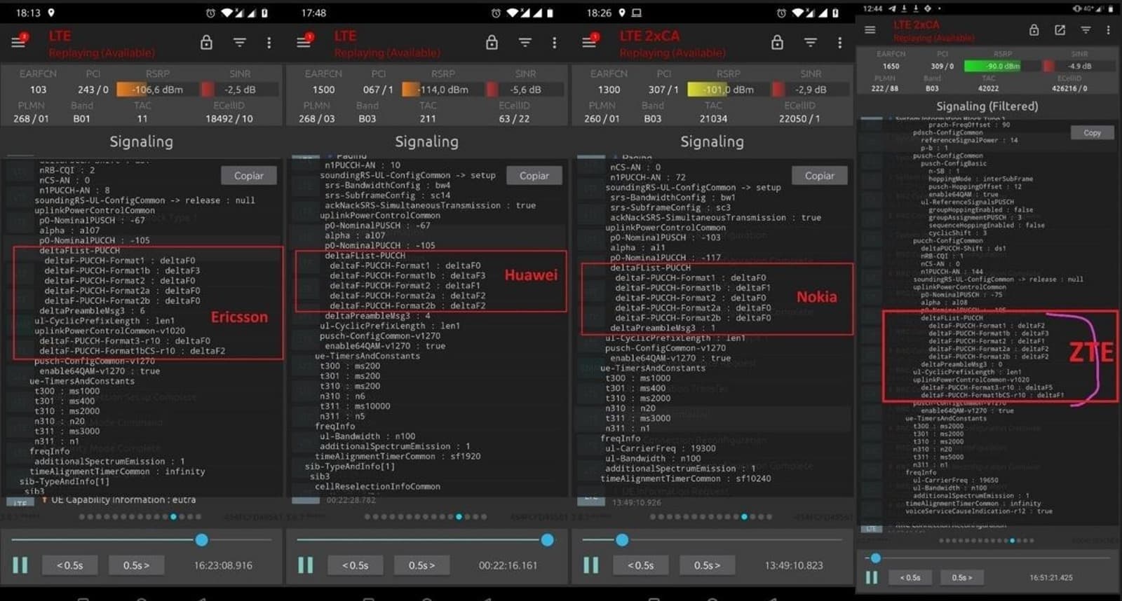

Is there a way one can know the Vendor from drive test log files?
I think Yes, from extension of log file we can guess, like for Nemo .nmf
I think he wants to know the “RAN” vendor.
An I think it is not possible.
Yes, from SIB2 LTE.
But I miss values from Samsung LTE SIB 2.
Hmmm… These seems like standard configuration which can be setup in any vendor.
I didn’t know Vendor type information was possible via logs…
Yes it is true.
Vendors do no change those values.
Give it a try and you will see values are good for each vendor.
Sometimes it can be changed like I’ve seen Ericsson delta values on Nokia network and about samsung Sib2 it’s totally random for different networks so can’t identify using logs
