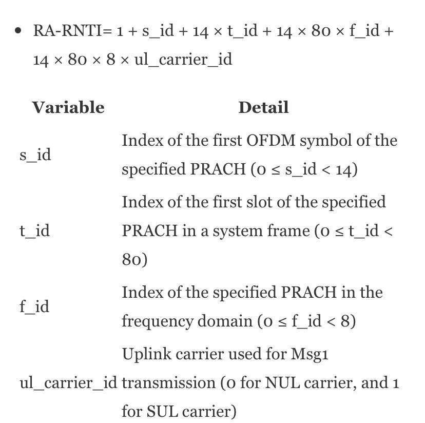

Yes, here is the formula from 38.321.
Yup… Location of msg1 to be precise.
