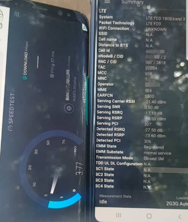

RSSI value closer to -121, -120 comes under cold RSSI.
- RSSI is -21 dBm
- RSRQ is -17 dB
- RSRP is -58 dBm
- SINR is 0.5 dB

I have tried making maintainance mode of neighbouring site and got normal SINR.
The rca is mode 3 interference.
After PCI modification, SINR is normal now.
