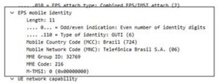

One other thing we observed:
When logging S1AP msgs at BTS we can see the Attach request using GUTI, but TMSI fild comes all whith zeros (000000000).
Great, this seems the root cause.
It seems UE might detected that its GUTI is no longer valid (e.g., due to timeout or moving to a new tracking area where the GUTI is not recognized).
Consequently, it sends an all-zeros M-TMSI as a placeholder.
If device detects its GUTI is no longer valid, why not go with IMSI?
Good question.
But it’s bit tricky to confirm its MME issue or UE…
As per my understanding ,Rejection Cause Codes: Ensure that MME sends a specific rejection cause code (e.g., “GUTI not valid”) that prompts the UE to fallback to IMSI.
