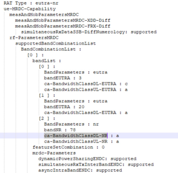

In UE capability message did you check UE declares its non support on your combinations properly?

Another issue is we cant have UE capability insight neither from logs nor from cacombos as its a CPE not UE.
I see. You can ask core guys to start an imsi trace from CMM to capture UE capability during attach.
Without checking Ue cap , it is difficult to troubleshoot this. Probably CPE does send support for the band combination you are asking for.
