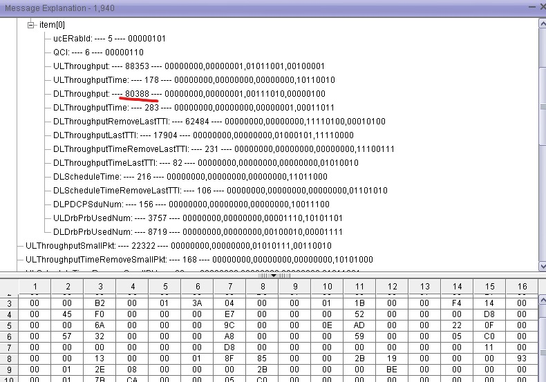

Can anyone please tell me what is the unit for that DL throughput?
Also from where I can get the mapping value of tracing logs system information?
This is from Huawei RAN.
You should get explanation in hedex for it.
(Dlthroughput-dlthroughputlastTTI) * 8 * 1000 / dlthroughputtimeremovellastTTI / 1024 = kbps.
Same goes with UL.
