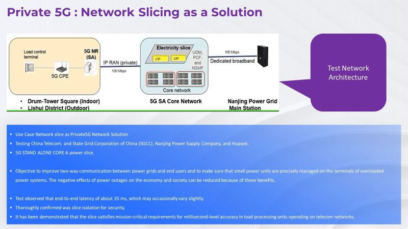

In China, the first electricity network slice test in the sector was carried out in Nanjing during 2019 by China Telecom Jiangsu, State Grid Corporation of China (SGCC), Nanjing Power Supply Company, and Huawei.
The millisecond-level latency advantage on 5G networks and SLA assurance of network slicing are fully leveraged by the SA power slice. It improves two-way communication between power grids and end users and makes sure that small power units are precisely managed on the terminals of overloaded power systems. The negative effects of power outages on the economy and society are reduced because to these benefits.
For the electrical slice, run a test network.
The processing of power servers, transmission of network instructions, and processing of load control terminals were found to have an end-to-end latency of about 35 ms, which may occasionally vary slightly. Also thoroughly confirmed was slice isolation. It has been demonstrated that the slice satisfies mission-critical requirements for millisecond-level accuracy in load processing units operating on telecom networks.
