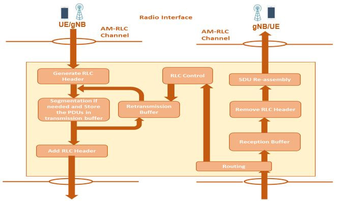

RLC AM has retransmission buffer, so it can do retransmission if NACK.

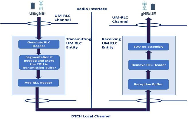

But RLC UM not has retransmission buffer, so if NACK it can not do retransmission because old data is not kept.
