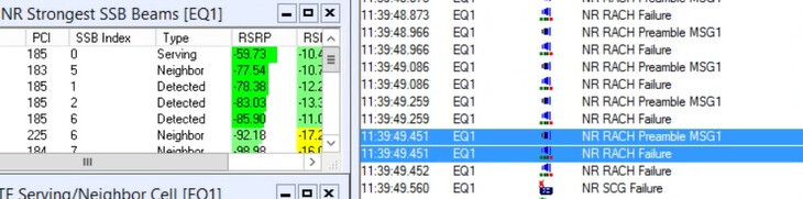

I am facing SCG failures in Nokia (NSA) and majority of the failures are occurring during Random Access Procedure mainly msg2 failures.
Maximum Preamble Transmission Count is N7(20) but majority of the cases RA attempts are even less than this and cause RACH failure and result into SCG fail.

B1 is -110.
BTW NR rf is better than B1 in all cases.

First thing to check any UL/DL intereference.
RACH failures are also happening when there’s no dominance.
That is no clear best serving PCI.
Yes, interference is there, but competitors have less ratio of these failures despite interference existence.
I think in our case, it appears that dominance is not the issue.
play with raresponsewindow. msg2 failures are happening cuz of 2 reasons, DL interferece and false msg1 (ghost RACH) attempts…
At failure location what is UE RSRP / SINR and UL SINR?
(Need to check at gNB)
For rach failure, be aware in 5G there are 3 types of SINR:
SSB SINR
CSI-RS SINR
PDSCH SINR
