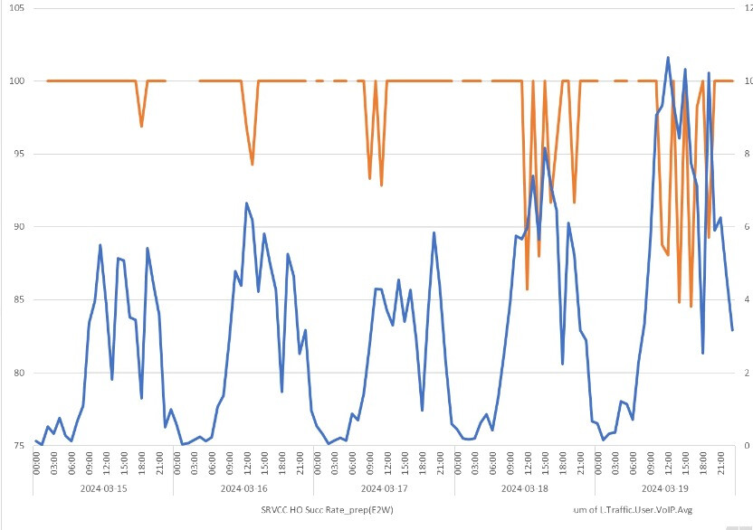

We are experiencing a significant increase in VoLTE SRVCC preparation failure alongside rising traffic.
We need to investigate whether the issue lies within the RAN side or if it’s related to the core network

First check on the top worst cell which I shared, lets see.
But why it was not before and due to increased in traffic it appears.
If it’s configuration issue then there must be some failure before as well.
