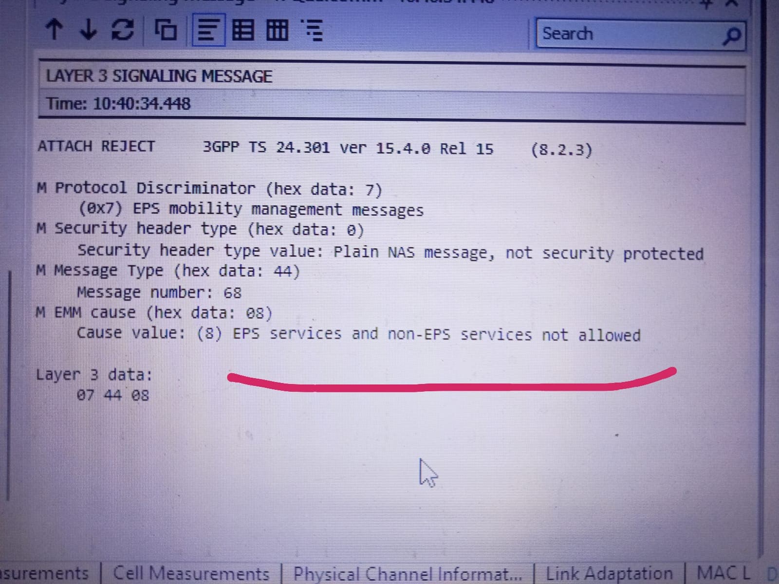

Hi Friends.
What may be the reason of “Attach Reject due to EPS Service or Non EPS service not allowed”.
Hi Friends.
This need to check from CORE side.
This cause value was flagging due to SIM Deactivation.
These details finally reflect at Core end only.
Yes. Very probably something with SIM card.
Mostly I have seen this for In roamers and these services are rejected due to authentication failure from diameter.
I once had a problem solved by applying “combined attach” and enabling a few QCI at EPC.
I hope it helps
Core issue!
APN, IMSI invalidation.
Core team need to fix this.
Thanks All: Issue resolved, after reactivation of SIM.
