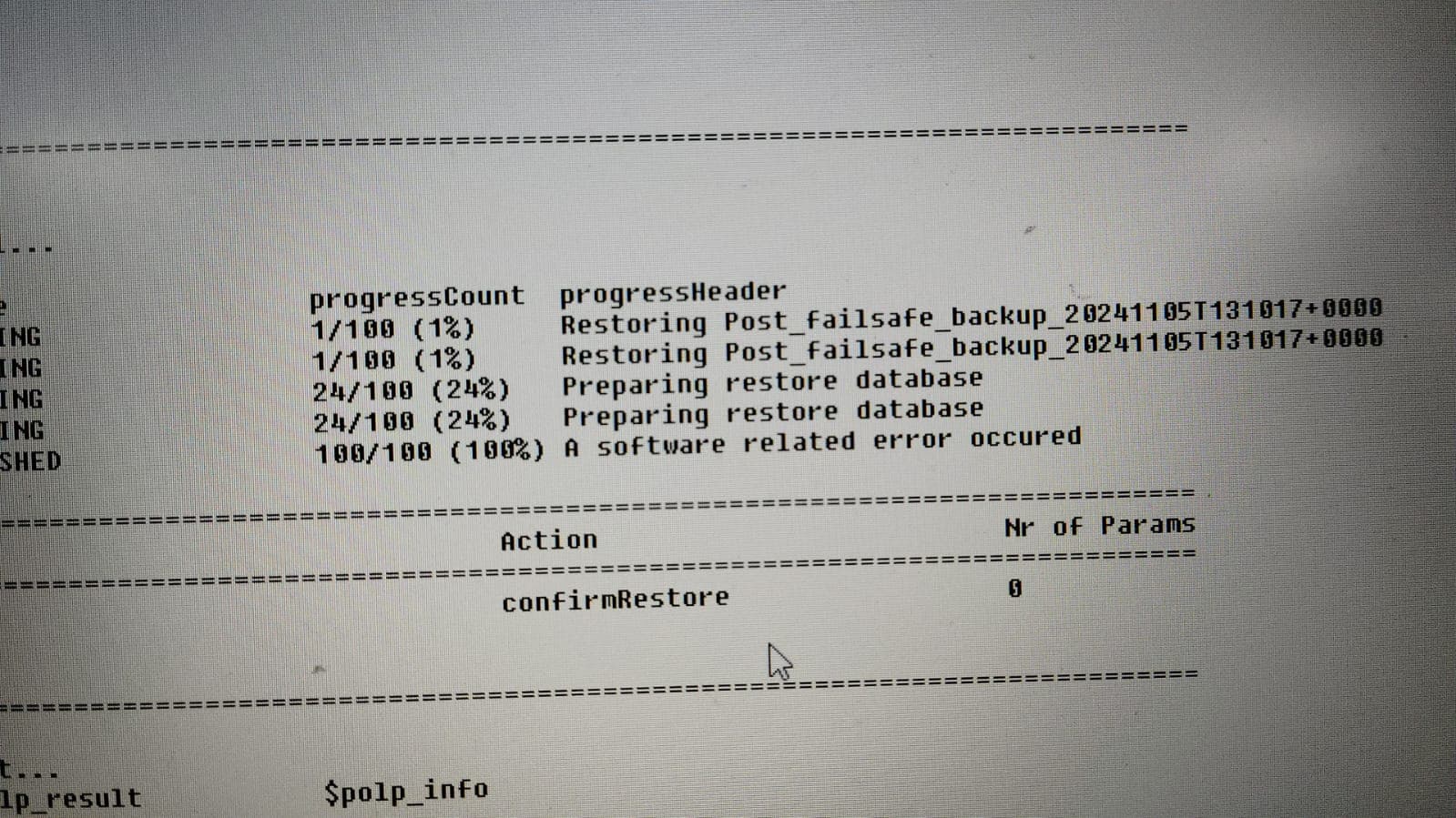

I am unable to revert any CV on the Ericsson 4G site and am getting the error “software related error occurred.”
Is there a solution to this issue other than performing a scratch load, as the site is in unsynced mode and a software upgrade cannot be performed?

When attempting to revert to the old CV, I am encountering the error “software related error occurred.”

I think the software might be corrupted. I’m planning to perform a scratch load.
