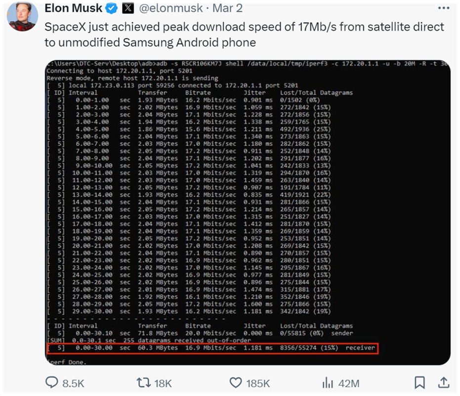

In March 2024, Elon Musk posted results of iperf test for Direct to cell system (LTE signal from LEO satellite directly to unmodified LTE phone).
As we can see, results are 16.9 Mbit/s | 1.181ms jitter | 15% packet loss

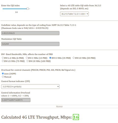

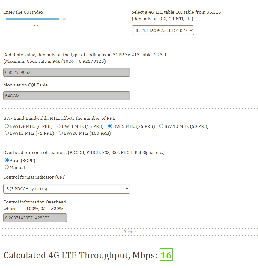

How did they get it?
Channel BW: 5 MHz
Even though we assume 3 PDCCH symbols for control channel we can get 16Mbps with CQI index 14 and 64QAM modulation.
Do you believe that in DL they managed to get 64QAM to achieve 16Mbps?

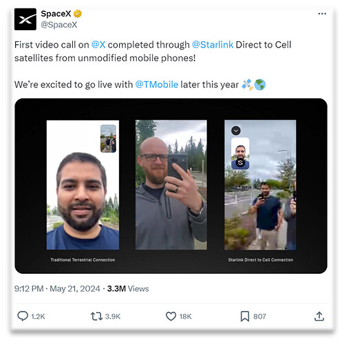

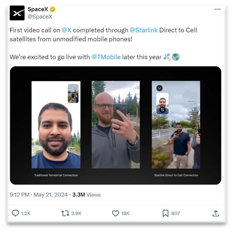

Hi,
Thanks for your reply!
I don’t know about VoLTE call, but I know they’ve managed to establish video call (maybe OTT).
