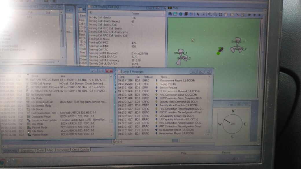

Suggestion to issue where one of the cell site CFSB calls are getting blocked when selected preferred mode is LTE
Hi… Any suggestion in one of the cell site Csfb calls are getting blocked when preferred mode selected as lte
Manual mode to GSM calls are getting through
Don’t lock the phone to LTE in TEMS
It’s in auto mode

Can u please share snap of events

The message from block call … T3417 expiry
