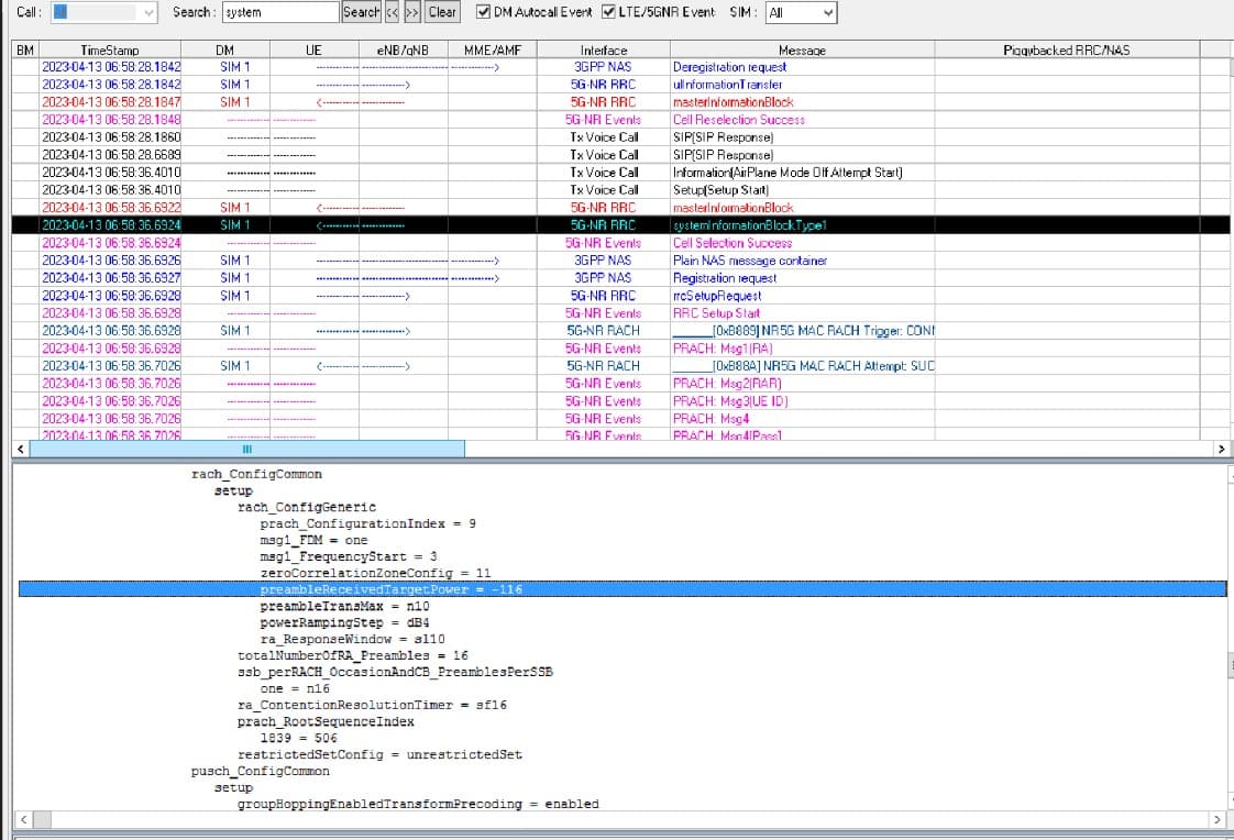

Hello All.
We have set in some cases preamble as -116.
We have contention base cases for initial access and handovers.
Is it too high for msg1 to send request?
-104 could be used.
-116 is too low.
I think preamblereceived target power can be anything between -110 dBm and -104 dBm
It is useless to have RACH success at -116 dBm if RRC will fail later.

But in DT I am seeing msg 2 failures
Mainly where RSRP is -110, -115 and sometimes it is not able to trigger a3.
Only MR goes.
I have both initial access and handovers as contention based.
Why it is not able to trigger a3 then?
In some cases mainly epsfallback.

Window size is s110.
But fails happening after RRC request.
I have two cases one is rapid mismatch and another is ct expiry.
Sometimes my serving is -95 and neighbor is -75 , measurement goes no a3 trigger.
Sometimes rrc request is also seen in some times.
RACH ct expiry seen in both initial access and handovers.

RSI mismatch is seen, ANR is there.
RSI sequence mismatch seen.
As wrong PRACH RSI configuration in event root cause.
After that mcg wrong to ho cell.
