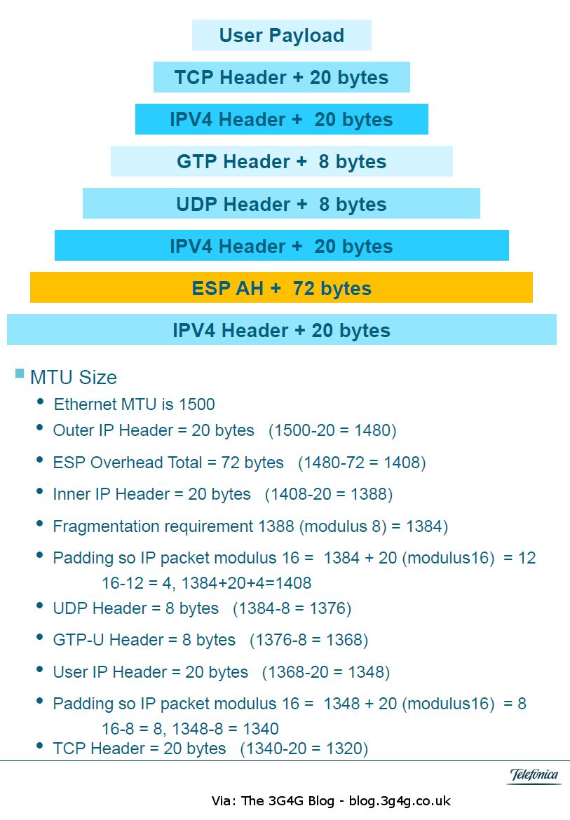

Does this help? Securing Backhaul with LTE.
This article is for LTE, but the principle remains the same.
Remember, if a higher layer packet size exceeds the lower layer’s limit, it will be fragmented accordingly.
Also, try searching for MTU in LTE or MTU in 5G—there are some good resources available online.
