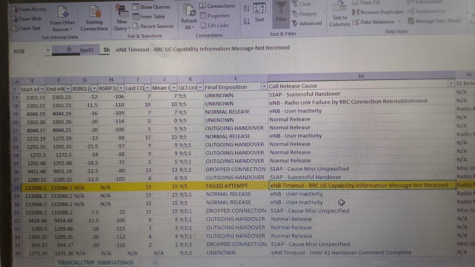

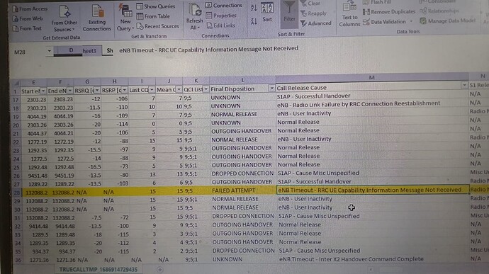

This is the case of epsb failure due to rlf and cause I am getting is eNB Timeout - RRC UE Capability Information Message Not Received
Then it is due to poor Uplink that eNodeB does not receive UE capability information.
But this is not a Radio Link Failure.

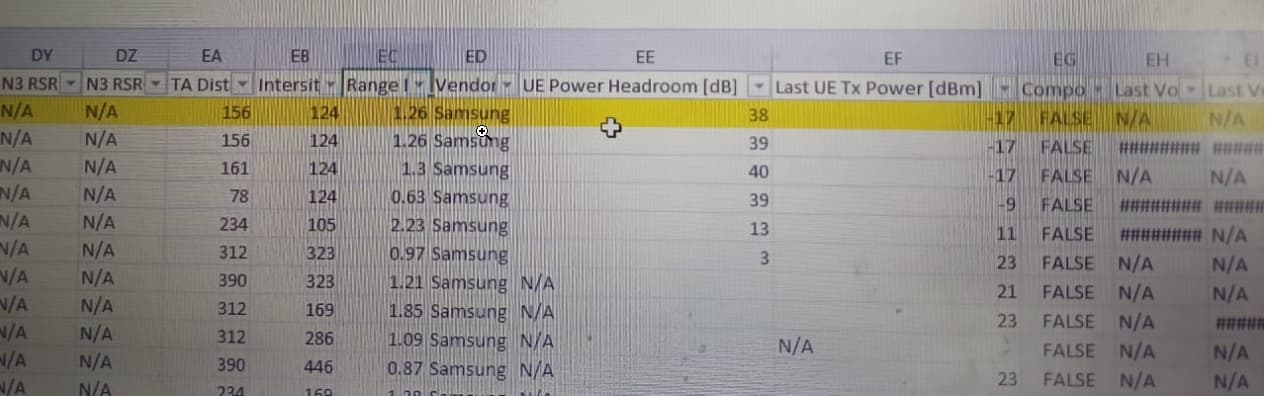

Check RSRP and check UE TX power if it reached 23 dBm.
This is the reported UE power headroom and UE power during failure.
