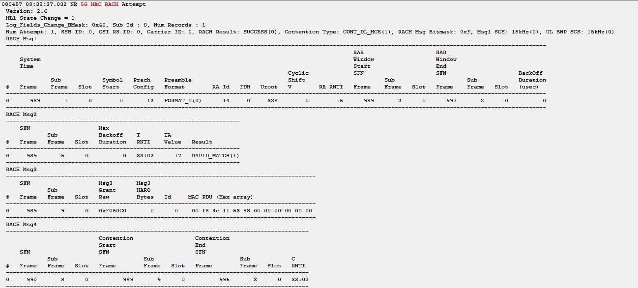

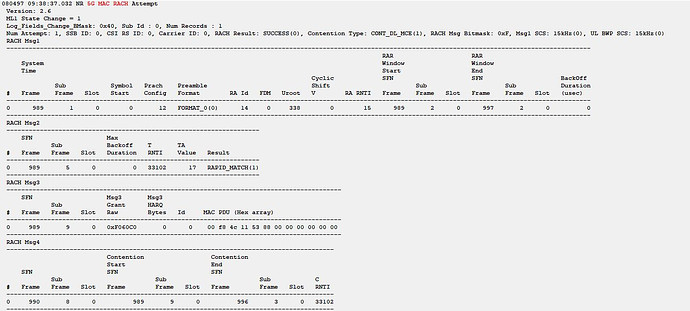

True, now my question is: what exactly are the contents of MSG3?
I see the MAC PDU as all zeros.
Is it possible that it’s just a MAC PDU full of padding?
Yes, all MAC PDU of msg 3 are zero in all 5G NR MAC, probably scrambled with T-RNTI!?
Oops there are cases when MAC PDU for rach are not zero… see this example:
