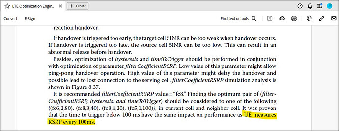

I was reading this in “LTE Optimization Engineering Handbook”, so I thought to share in the group for correct answers.
