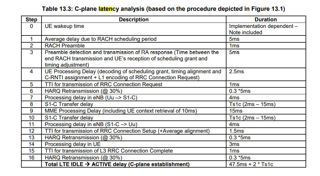

Check here:
Source: https://www.etsi.org/deliver/etsi_tr/125900_125999/125912/09.00.00_60/tr_125912v090000p.pdf
Page 45
I see for retransmission is 30%.
