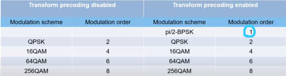

It’s because of pi/2 BPSK modulation used.
Pi/2 BPSK is a lower order modulation which reduces the SINR requirement for correct symbol detection.
It also has a lower PAPR which helps the UE to operate more efficiently and with a higher average power.

Also format 3/4 uses DFT-S-OFDM modulation where transform precoding used & with pi/2 lower modulation order can be used which helps very low SNR transmission in a large cell.
