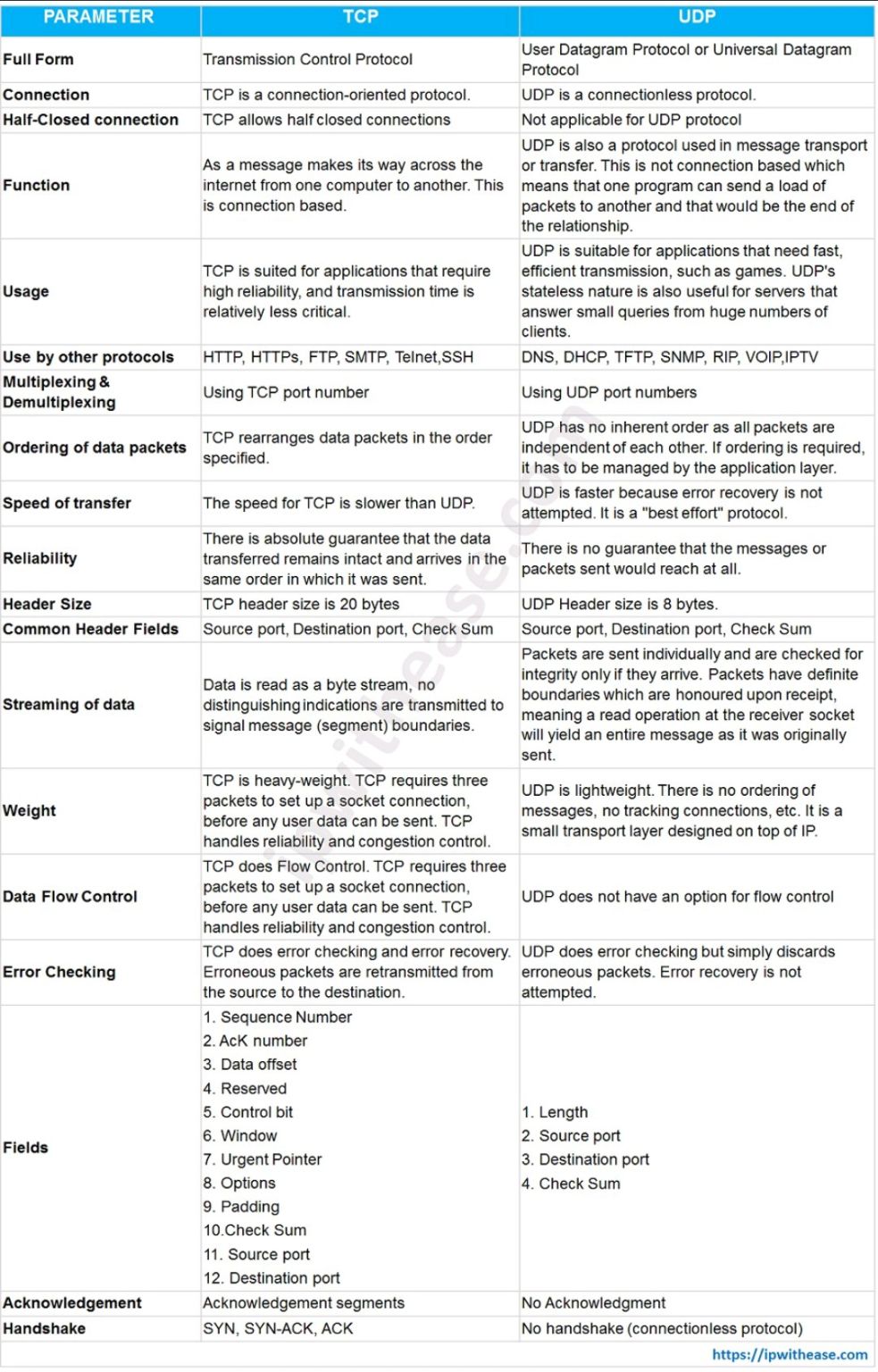

Interesting complementary (extra and related) reading:
TCP vs. UDP — What’s the Difference and Which Protocol is Faster?
  • If you’re getting into computer networking, or if you’ve dug through the network settings of some applications, you’ve likely seen these terms: TCP and UDP.
  • TCP, which stands for Transmission Control Protocol, and UDP, or User Datagram Protocol, are part of the internet protocol suite. TCP and UDP are different methods to send information across the internet.
  • But even knowing what they stand for, it’s hard to know which protocol you should use, or why you would use one over the other.
  • In this article, we’ll go over computer networking basics, the differences between TCP and UDP, when each is used, and more.
  • Computer Networking Basics
    Before diving into how TCP and UDP work, it’s helpful to know the basics about how the internet works.
  • Generally speaking, the internet is a network of connecting devices. Each device, whether it’s your smartphone or a server, communicate through the internet protocol suite.
  • The internet protocol suite is a collection of different protocols, or methods, for devices to communicate with each other. Both TCP and UDP are major protocols within the internet protocol suite:
  • Each device that’s connected to the internet has a unique IP address. And whenever two devices communicate over the internet, they’re likely using either TCP or UDP to do so.
  • Here’s a brief comparison between the two: Check out this below :point_down: image for difference between TCP and UDP.
  • I hope this content helped you understand some of the nuances between TCP and UDP. **And if someone asks which is faster, tell 'em what you read here: "UDP is faster.**:+1:
